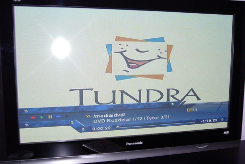

    Btw.external DVD connected by usb works good with Ipbox + E2 We can play divx, mpeg, vob, mp3...files
    and screen from user @glob9
    La mine au mers files avi care am mutat la HD fara probleme.Am transferat si files iso care a fost filme din DVD si au mers si asta fara probleme si cu subtitle.Cu aparat DVD nu am incercat inca...
