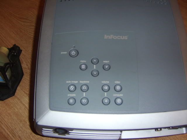

    1. Press and hold the Volume + button.
    2. Then press the Volume – button.
    3. Hold both buttons down for 5 seconds.

    Yky ai o de la mine! Prima varianta e corecta.
