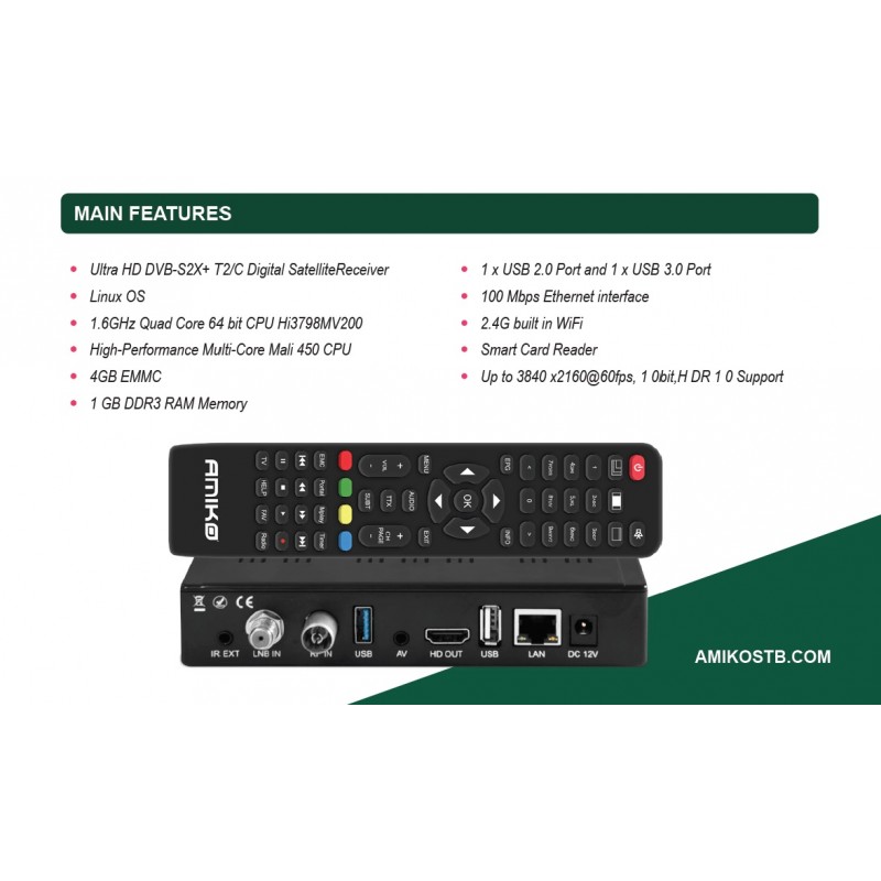

    Ultra HD DVB-S2X+ T2/C Digital Satellite Receiver
    Linux OS
    1.6GHz Quad Core 64 bit CPU Hi3798MV200
    High-Performance Multi-Core Mali 450 CPU
    4GB EMMC
    1 GB DDR3 RAM Memory
    1 x USB 2.0 Port and 1 x USB 3.0 Port
    100 Mbps Ethernet interface
    2.4G built in WiFi
    Smart Card Reader
    Up to 3840 x2160@60fps, 1 0bit,H DR 1 0 Support
