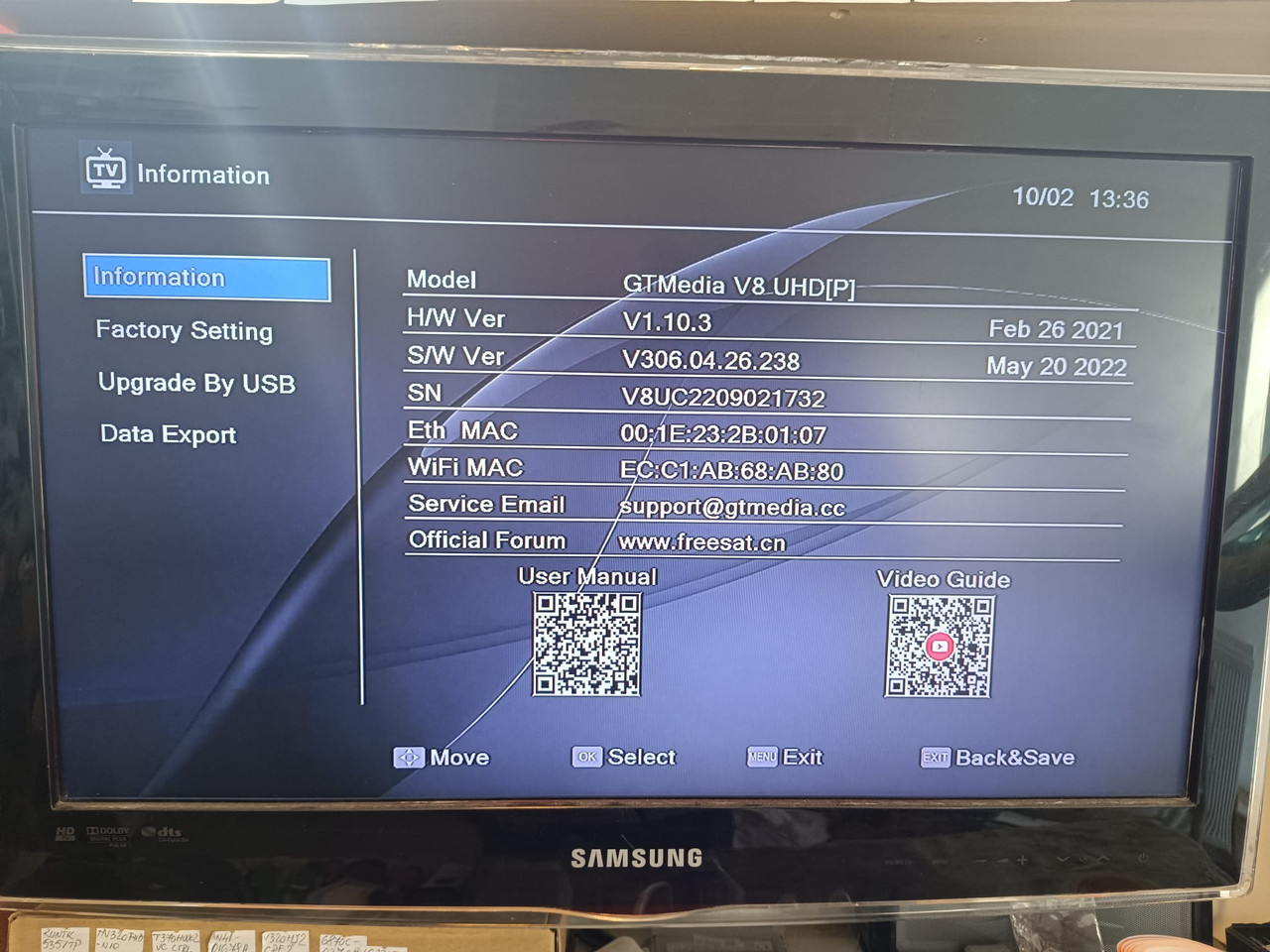

    V8UHD upgrade Mars:
    1.To upgrade the v8uhd mars firmware from the original v8uhd firmware, you need to copy the backdoor.key and v8uhd mars firmware files to the usb root directory.
    2.then enter the "upgrade by usb" menu, select the upgrade mode as 'All code', do upgrade.
    Cred ca backdoor.key care le am nu sunt ok, are marime doar 1B
    9,023
    Arhivele urcate de mine pe yandex contin bk key.
    Nu mai descarca soft de la terti!

    am inteles, si care ma sfatuiti sa-l pun acum sau in ce ordine. multumesc
    9,023
    Pune ultimul disponibil la download: Mars V8 UHD_V1.11.19315_29102025.bin apoi faci update online.
    Vezi ca deschide cablu dupa 2 restarturi.
