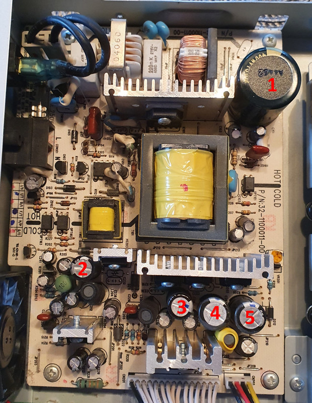

    Azi am mai luat un 922, arata mai bine dar are condensatoarele stricate, merge cateva minute si ii moare sursa.
    Nu am timp de el dar adun in acest topic informatii.
    1: 150 muF, 400 V, 85°C
    2: 1500 muF, 10 V, 105°C
    3: Unknown
    4: 5: 1500 muF, 16 V, 105°C
    Code:
    Elko-Liste UFS 922
    P/N: 32-1100011-00 Modell AD08012M Rev 1.1
    Sicherung (Glas) : T6,3AL , 250V
    Bez.	V	mF
    C101	400	150
    C103	50	22
    C104	50	1
    C108	50	1
    C?	50	47	(neben 230V Stecker)
    C201	10	470
    C202	10	470
    C203	16	1500
    C204	16	1500
    C205	16	470
    C211	10	1500
    C212	10	470
    C213	10	470
    C216	25	680
    C218	25	100
    C219	25	100
    C227	50	1
    C228	50	1
    C238	50	47
    C239	50	47
    C240	50	1
    C241	50	10
    Mainboard
    C37	50	220
    C40	?	1000
    C41	10	1000
    C115	10	680
    C151	50	100
    C157	50	220
    C624	50	470
    C835	10	2200
    C956	50	100
