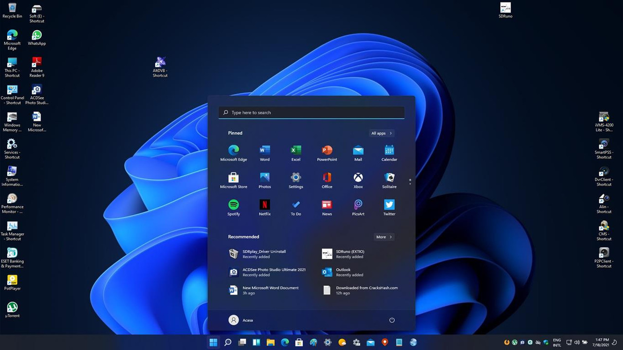

    Microsoft removed a registry hack in the latest preview build that allowed Windows 11 users to revert to the "Classic" Windows 10 Start Menu.
    When the Windows 11 preview build was leaked in June, one of the most significant and most controversial changes was a new floating Start Menu centered in the middle of the Taskbar.
    This new Start Menu was taken from the now-shelved Windows 10X and includes a redesigned interface with the removal of app groups and Live Tiles.
    For those who did not like the new Start Menu, it was possible to use a Registry hack to revert to a "Classic Mode," the Windows 10 Start Menu.
    To switch to the Windows 10 Start Menu, users could create the 'Start_ShowClassicMode' value and set it to 1 under the HKEY_CURRENT_USER\Software\Microsoft\Windows\CurrentVersion\Explorer\Advanced registry key.

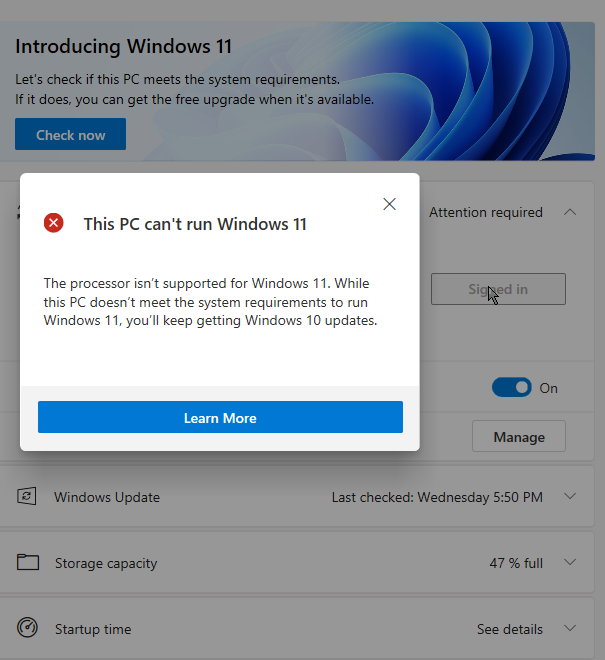

    Modul de acces la butonul Start nu-i o problema pentru Windows 11,si deci nu ar trebui sa ne ingrjoreze.Ceea ce cu adevarat va da bataie de cap multor utilizatori de Windows,sint cerintele hardwares pe care trebuie sa le indeplineasca calculatorul ca aceasta versiune noua sa se instaleze(si gratuit)!Care sint acestea,se poate vedea din specificatiile Microsoft.
    Din pacate,desi indeplinesc aproape toate cerintele pentru W11,aflu cu ajutorul lui PC Health ca,vai, procesorul Intel i7-7700 nu-i inclus in lista procesoarele valabile pentru trecerea la noua versiune

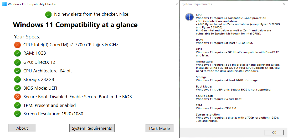

    Cu Windows 11 Compatibily Checker am aflat mai multe despre conditiile ce trebuie sa le am pentru calculatorul meu ca sa pot instala W11.
