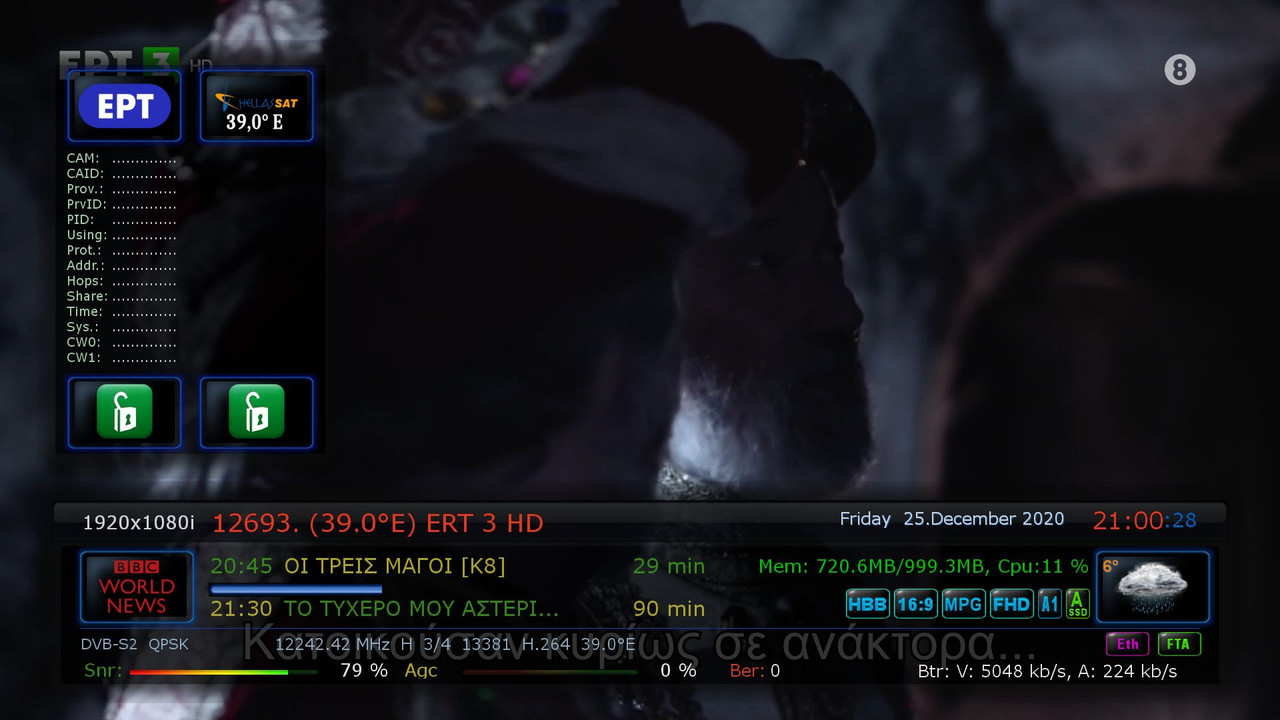

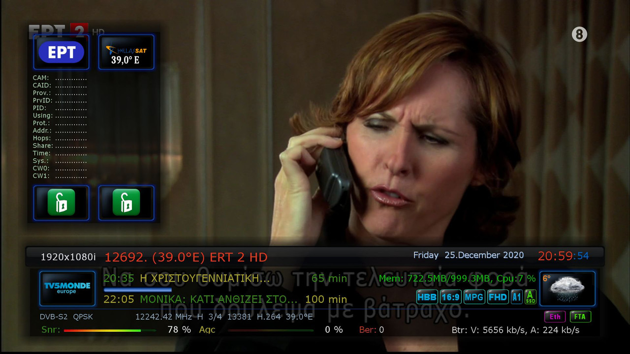

    Buna.
    Pe receptorul meu DM 920 cu imagine Newnigma 2 am reusit sa fac sa deschida programele EPT.
    Ce am facut.
    Editat in softcam.key urmatoarele linii pentru EPT 2 HD si 3 HD.
    F 00010080 00 XXXXXXXXXXXXXXX ;EPT 2 HD (39.0°E)
    F 00010080 01 XXXXXXXXXXXXXXX ;EPT 2 HD (39.0°E)
    F 00020081 00 XXXXXXXXXXXXXXX ;EPT 3 HD (39.0°E)
    F 00020081 01 XXXXXXXXXXXXXXX ;EPT 3 HD (39.0°E)
    In oscam.dvapi se adauga.
    P 2600
    A: ::0028:0102::: 2600:000000:1FFF ; EPT 1 HD (39.0E)
    A: ::000A:0104::: 2600:000000:1FFF ; EPT 1 (39.0E)
    A: ::0014:0100::: 2600:000000:1FFF ; EPT 2 (39.0E)
    A: ::0001:0030::: 2600:000000:1FFF ; EPT 2 HD (39.0E)
    A: ::0002:0101::: 2600:000000:1FFF ; EPT 3 HD (39.0E)
    Si doua imagini ca functioneaza.
    2020/12/25 21:00:21 26322A61 r (emu) Key found: F 00020081 00000000
    2020/12/25 21:00:22 7E2000D5 c (ecm) dvbapiau (2600@000000/0000/0002/15:C92A260BAB8A520EDE4E6A042248116E): found (1 ms) by emulator (L/1/2/2) - ERT 3 HD
    2020/12/25 21:11:36 26322A61 r (emu) Key found: F 00010080 00000000
    2020/12/25 21:11:36 7E2000D5 c (ecm) dvbapiau (2600@000000/0000/0001/15:83DFF2D85D1AA27BA2CFB4745AF25EF7): found (1 ms) by emulator (L/1/2/2) - TEST 1

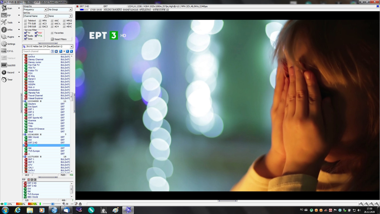

    Functioneaza si pe alte imagini sau receptoare. Pe DM920 am testat cu DElite, pe Octagon sf8008, amiko Viper 4K cu openatv 6.4, 6.5
    Dar nu reusesc deloc sa am lumina cu aplicatiile dvb, azi am stat toata ziua pe DVB Viewer si nimic cu v-plug, oricat l-am sucit.
    Sunt convins ca trebuie sa mearga si pe emulatoare cu tuner DVB, dar nu stiu cum se face.

    @ dingo31
    Cu DCC editeaza un softcam.key pentru placi DVB, si adauga liniile de mai jos.
    F 00281FFF 00 XXXXXXXXXXXXXXX ;ERT 1 HD (39.0°E)
    F 00281FFF 01 XXXXXXXXXXXXXXX ;ERT 1 HD (39.0°E)
    F 00011FFF 00 XXXXXXXXXXXXXXX ;ERT 2 HD (39.0°E)
    F 00011FFF 01 XXXXXXXXXXXXXXX ;ERT 2 HD (39.0°E)
    F 00021FFF 00 XXXXXXXXXXXXXXX ;ERT 3 HD (39.0°E)
    F 00021FFF 01 XXXXXXXXXXXXXXX ;ERT 3 HD (39.0°E)
    F 000A1FFF 00 XXXXXXXXXXXXXXX ;ERT 1 (39.0°E)
    F 000A1FFF 01 XXXXXXXXXXXXXXX ;ERT 1 (39.0°E)
    F 00141FFF 00 XXXXXXXXXXXXXXX ;ERT 2 (39.0°E)
    F 00141FFF 01 XXXXXXXXXXXXXXX ;ERT 2 (39.0°E)
    F 00231FFF 00 XXXXXXXXXXXXXXX ;ERT 3 (39.0°E)
    F 00231FFF 01 XXXXXXXXXXXXXXX ;ERT 3 (39.0°E)
    Pornesti aplicatia cu v-plug si se deactiveaza autoECM, auto PMT, autoCAT, si se apasa pe v-plug editor dai calea la softcam din folderul aplicatiei
    unde este v-plug, import softcam, convert, si sa ai bifat keep all&import only new record.
    O imagine cum functioneaza.
    Insista sa faci sa incarce cheile din softcam.key, si trebuie sa merga.
