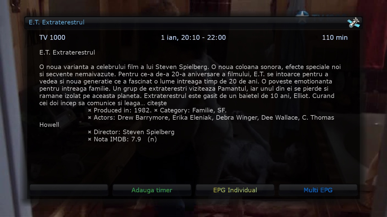

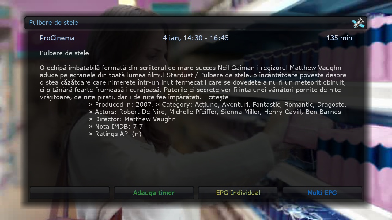

Cred ca am terminat de configurat webgrab, probleme mai am cu diacriticile si cu niste scripturi de pus in crontab.
Rezultatul

In run.sh la sfarsit am adaugat 2 linii + 2 de pauza intre ele, prima sa faca arhiva xz si a doua sa copieze aceasta arhiva in folderul web (http) de unde s-o ia EPGImporterCode:<desc>'description'{\n\t¤ Produced in: 'productiondate'. }{¤ Category: 'category(, )'. }{\n\t¤ Actors: 'actor(, )'}{\n\t¤ Director: 'director(, )'}{\n\t¤ Presenter: 'presenter(, )'} {\n\t¤ Nota 'starrating' } {\n\t¤ Ratings 'rating' }</desc> <credits></credits> <episode-num></episode-num> <date></date> <category></category> <review>{Ratings: 'rating(, )'.}</review> <rating></rating> <star-rating></star-rating>
