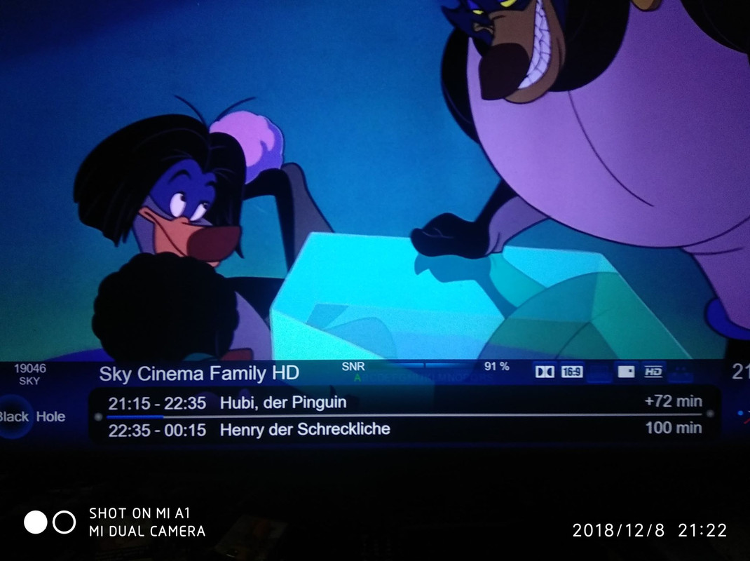

    Da o rescanare,sau facut niste modificari!
    PS!
    Actualizeaza cu:
    http://www.vhannibal.net/
    ---------- Post added at 21:25 ---------- Previous post was at 20:48 ----------
    Merg toate,semnal neschimbat,trebuie doar sa actualizezi lista cu transporderi,sau facut niste modificari.
