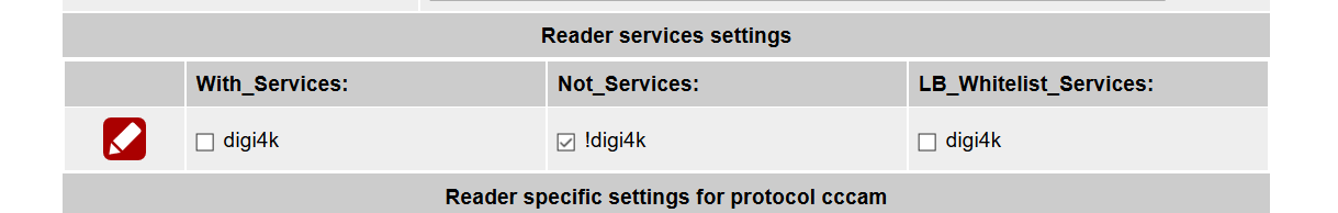

    Azi am lasat H7C sa inregistreze o emisiune de pe Digi 4k si am observat ca oscamul nu stie ce face cam-ul si cere de nebun din linii.
    Solutia e simpla:
    LE: folositi solutia de mai jos, e cu rosu
    si la readere puneti asa:
    Rezultatul:
    Code:
    2019/03/22 16:41:23 68871EE8 c   (dvbapi) Demuxer 0 ecmpid 0 CAID: 1880 ECM_PID: 15CD PROVID: 000000
    2019/03/22 16:41:23 68871EE8 c   (dvbapi) Demuxer 0 ecmpid 1 CAID: 06BB ECM_PID: 1B13 PROVID: 000000
    2019/03/22 16:41:23 68871EE8 c   (dvbapi) Demuxer 0 ecmpid 2 CAID: 1874 ECM_PID: 1B45 PROVID: 000000
    2019/03/22 16:41:23 68871EE8 c   (dvbapi) Demuxer 0 found 3 ECMpids and 2 STREAMpids in caPMT
    2019/03/22 16:41:23 68871EE8 c   (dvbapi) Demuxer 0 no suitable readers found that can be used for decoding!
    2019/03/22 16:41:24 68871EE8 c   (dvbapi) Demuxer 0 found 3 ECMpids and 2 STREAMpids in PMT
    2019/03/22 16:41:27 68871EE8 c   (dvbapi) Demuxer 0 no enabled matching ecmpids -> decoding is waiting for matching readers!
    Puteti edita direct fila oscam.services

    ---------- Post added at 17:03 ---------- Previous post was at 16:42 ----------
    Alta solutie sa puneti in oscam.dvbapi:
    Code:
    I:1880,1874,06BB::02A8

    Multumim @zildan pt.solutie am pus in oscam dvapi asa cum ai spus : I:1880,1874,06BB::02A8

    Salutare!
    Am un Zgemma H7C cu un cam digi4k. Am urmat instructiunile din postarea de mai sus pentru a face cam ul sa nu mai ceara linii, dar nu reusesc.
    Am OSCam r11505, descarcat de la sectiunea plugin din receptor.
    Va rog o solutie in a rezolva situatia creata.
