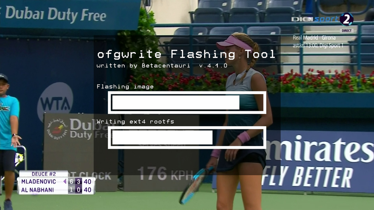

  3. #48
    19 May 2007
    Da am reusit de mai multe ori, am formatat stick-ul in fat32 is am dezarhivat imaginea pe stik.
    La dezarhivare trebuie sa creeze un director zgemma si in directorul creat un subdirector numit h7 deci de forma /zhemma/h7 in subdirector va avea in general 4 fisiere obligatoriu:
    disk.img rootfs.tar.bz2 si kernel.bin, mai contine si imageversion.
    Aceasta metoda se foloseste in general cind nu mai booteaza sau la inceput pentru a crea cele 4 partitii cu imagini diferite sau doua...
    DM500, DM800HD, KATHREIN UFS910 si altele

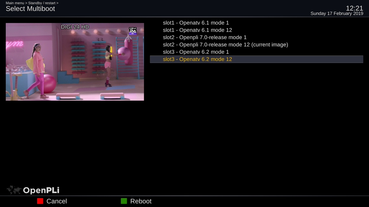

    Poate va ajuta asta
    How to install an Image to Multiboot:
    Download your Image for install on multiboot.
    IMPORTANT Don´t unzip the .zip File
    Then shift it to the USB Drive
    Plug the USB Device in the HD51.
    Step 1: Press the blue key on the remote, then press the right key and go to Flash Online
    Step 2: Now press the yellow button, now below might stand STARTUP_2 (it gives Startup 2,3. 4).
    Step 3: Press the blue key and now the yellow key then go to your USB Device
    Step 4: Go to the .zip and press the green button on the remote.
    Step 5: Now the Ax is flashing the Image
    How to use Multiboot:
    Step 1: Press MENU on your remote and go to Standby/Restart then go to Multiboot and press OK
    Step 2: Now you can select your image with the right/left key and start with the OK key
    sau metoda asta de aici - https://www.linuxsat-support.com/thr...nternal-flash/
  9. #54
    9,026
    M-am lamurit!
    Prin procedura stick USB, apasat buton din fatza, apoi power ON se instaleaza doar imaginile primare.
    Mai exact prima imagine din cele 4 posibile se scrie asa, dar face curat in flash,
    Imaginile primare scrise cu stickul sunt dezarhivate, 5 fisiere in directorul /zgemma/h7/ :
    Code:
    rootfs.tar.bz2
    disk.img
    imageversion
    kernel.bin
    noforce
    ---------- Post added at 22:49 ---------- Previous post was at 21:00 ----------
    La OpenPli e clara situatia, exista la orice buid o imagine multiboot, si una de update USB !!!!!
    La OpenATV altii exista doar imagine USB care se scrie multiboot.
