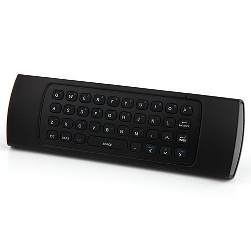

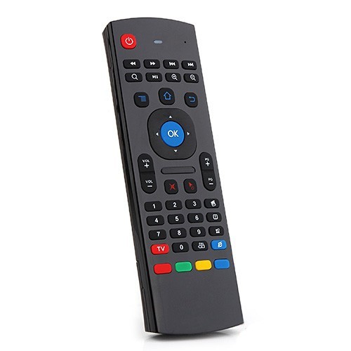

    Am cumparat si eu o "clona" de MX3- L 3, era la "solduri" la Auchan cu 40 lei.
    Nu are microfon si nici tastatura luminata, instructiunile de utilizare sunt total aiurea asa ca in prima faza am crezut ca e stricata si am verificat electronica din ea, nu reuseam sa o invat comenzi de tv.
    Dupa ce am cautat pe net am gasit mai multe instructiuni asa ca am pus-o in functiune.
    Merge foarte bine cu Samsungul Q6, si partea de tv si cea de smart.
    Remote learning feature
    If you would like your MX3 remote to learn some commands from another remote, then you can teach it to ‘copy’ the IR signal of the other remote. For instance, whilst the power button will turn your player off, it wont turn it back on because its not using the same ‘Turn on’ signal as your standard android remote. So here is what to do
    1) Get your standard android remote (or any remote that you want to replicate a button from) and place it end-to-end with the MX3 so that the IR receivers are facing each other.
    2) Then, on the MX3 press and hold the red TV button.
    You will see the LED flashing rapidly then slow to a steady flash (the steady flash means the X3 is now in ‘learning’ mode)
    4) Release the ‘TV’ button.
    5) Now press the power button on the standard remote (or whichever button you want to map) You will see the LED light stop flashing and glow continuously, at this point press the power button on your MX3 remote. The LED will then flash again and eventually extinguish.
    This means the MX3 has finished ‘learning’ the IR code from the other remote and has successfully mapped it to the power button
    Instructiuni detaliate inclusiv calibrare AICI
    1. A very common issue reported is the air mouse pointer drifting away by itself on screen. This is just due to a badly calibrated gyroscope...and apparently, none of "brand" selling this remote thought useful to document the simple calibration method available.
    This is by far the most important omission which lead many users to think they had a faulty device.
    Solution:
    Wake up the remote (press any button)
    Place the remote keyboard down on a flat surface
    Keep HOME + OK buttons pressed (as shown in the picture above) until the top LED starts blinking. When it turns off, the calibration is complete.
    Try the mouse cursor again: it should now stay still.
    2. Another undocumented tip: the hibernation mode can be disabled if you find it annoying by pressing the "Cursor Lock" button for 3 seconds.
    3. Finally, the instructions could also have included a note like this one: It is normal to not see any cursor on screen even if the pairing was successful. You need to press the Cursor Lock button first.
    Full RESET:
    That it is done by holding "TV" button and "DEL" fro a few second until the LED blinks.
