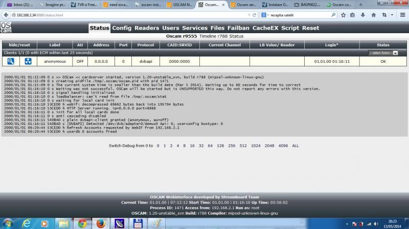

    ---------- Post added at 20:17 ---------- Previous post was at 20:02 ----------
    asta am acum , ce fac mai departe ?

    Acum incepi sa adaugi readerele si userii.
    Reader=> Add reader=>alegi tipul de reader din pop up si il demumesti dupa dorinta ta...
