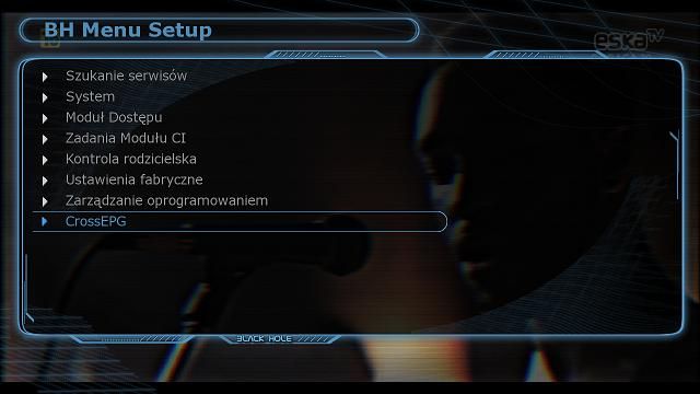

Press the Menu button on the STB remote control and select Settings {1}
2} Then select CrossEPG {2}
2.JPG 3} Press the Configure button in this menu you can set the location to store the EPG data.
The best place is on a USB stick, because it is fast. You should see a menu similar to the {3}
