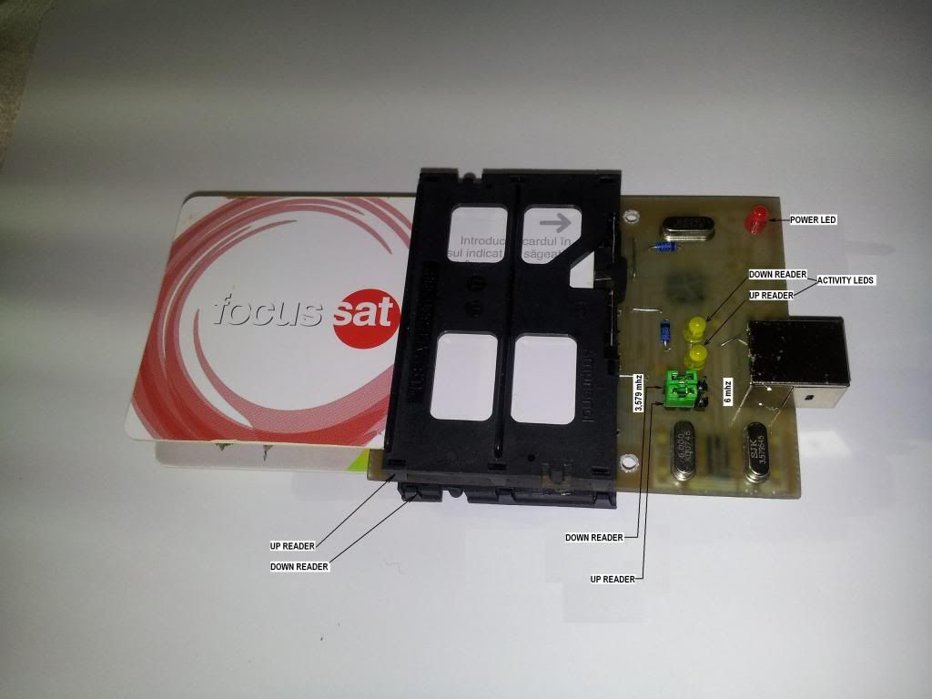

    Standard RSP member Ovizel's Avatar
    14 Sep 2007
    Cluj Napoca
    66
    Am incercat dar rezultatul...
    ERROR: Could not read reader->convention
    Asa ca, back to...
    mhz = 600
    cardmhz = 357
    Doar cu aceste setari obtin timpi mai mici.
    Interfata arata conform pozei
