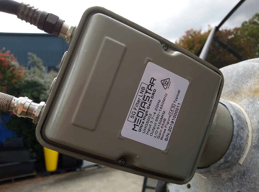

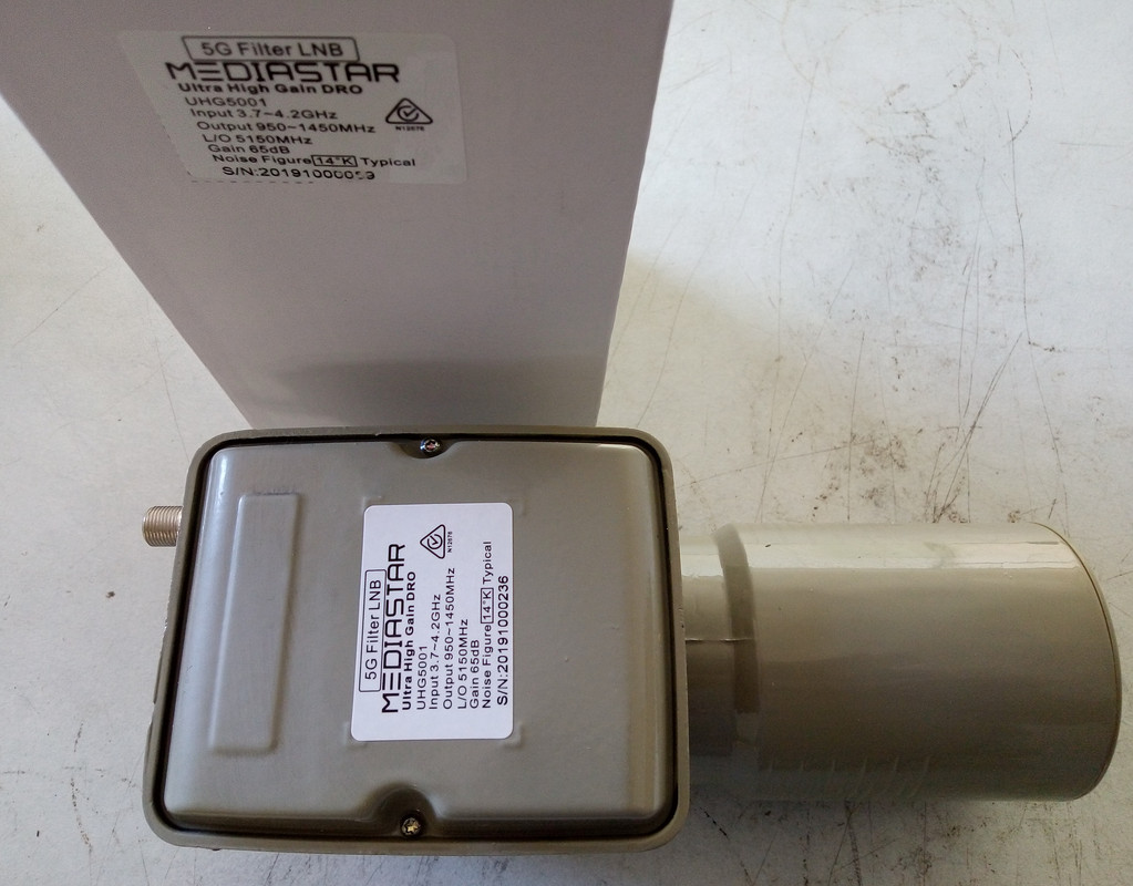

    Mediastar LNB with 5G filter
    in australia a aparut un nou model de lnb in banda C dotate cu filtru 5G
    mediastar.com.au
    https://i.postimg.cc/T3YvcwkP/5G-LNB.jpg---single input
    https://i.postimg.cc/rmbVsNkq/Dual.jpg-------------twin input

    I am happy to report that after mounting a new c-band LNB with a 5G filter builtin has stopped the interference to my parents AsiaSat-5 TVE reception.
    Mediastar and Satking now supply these LNB's for $100
    Thanks all for your help.

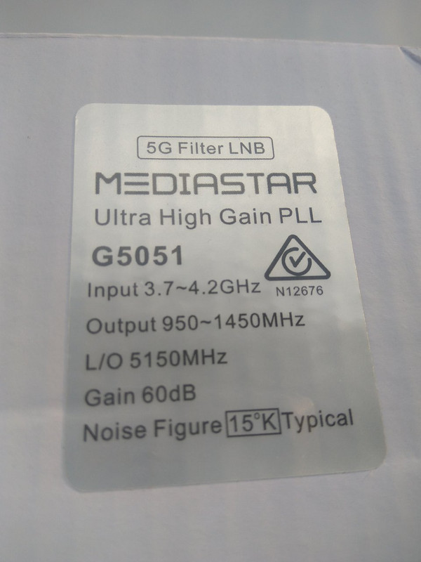

    anul trecut va informam pe acest forum despre aparitia unui lnb care este prevazut cu un filtru antiferenta 5G.
    in perioada urmatoare se vor efectua testele de rigoare pentru a vedea eficienta sa
    acest lnb a fost comandat de pe ebay .com.au si a costat 450+79lei vama (pasiunea costa prieteni stiu de ce )
    Asteptam testele cu interes
