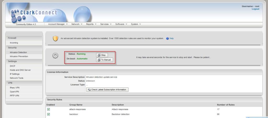

We just have to activate those program.
Clink on network-> intrusion detection
Press those two buttons. First button is to start the program and second is to start it on boot.
Do the same for intrusion prevention
Congratulation it’s done you’re Clarkconnect is much more safer and stable now
